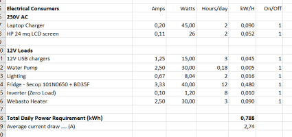

A 15A charger will keep up with those loads ... my average leisure battery load in a T6.1 Ocean is about 3A when camped up off-grid. If I turn everything on full, then 10A max on the leisure side. IMO a 25A charger gives a bit more headroom while still being well within the recommended charging current.
My data ...
My solar system is theoretically capable of providing around 25A and even though I have never seen this, it is more than enough to mean I don't need an electrical hook-up for the systems on my van.
