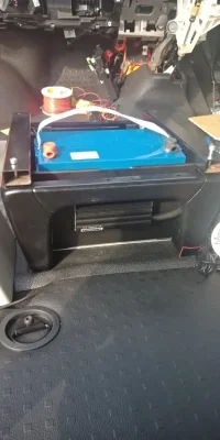

I have managed to shoehorn a Victron Superpack 100Ah, Redarc BCDC1240D, a 10 way fuse box, BMS712 shunt and various isolation switches and fuses under the passenger seat with use of a 30mm spacer to the seat rails (to get the height of the battery in-they don't advocate mounting the batteries on their sides), and a Victron 800W inverter and NOCO mains charger under the driver's seat with room to spare.
The mains breakers, changeover relay and such like will be fitted at the rear of the van in the bottom of one of the units, keeping the mains feed in cable to the recommended 2m or less.
