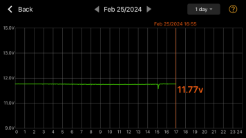

Hi all, we have a similar problem on our T6.1 Highline, March 2023 vintage. With the van parked up without use, we get 9 days from full charge (12.6v) to the low voltage warning (11.7v). Been back to VW but they declared there is not a problem with the battery, they suggested driving it more often. Plots from BM2 attached. The BM2 is set to lead-acid battery as I can't see any indication on the battery of type, no label or part number visible with the battery in-situ. As it's not a daily driver, it's a nuisance having to keep it charging the whole time, much quicker to drain when camping, doors open etc, adds an unwelcome stress to camping.
I have two questions;
Is there any way of telling what type of battery is fitted and if currently an ESB, would upgrading to AGM help to extend the life?
Is 9 days about right for full to flat or does that suggest a problem?

Looks like, after a drive, it's dropping below 12.0v within 3days.
So something not right.
Either the battery needs a full charge.
Or.
Something is draining the battery.
Or.
The battery is knackered.
Can you try connecting to a EHU charger for 24hrs to get a full charge in....then retest for a week.
Post a picture of the starter battery and van....
Have you got any 3rd.party electrics wired up?
How often does it get driven?

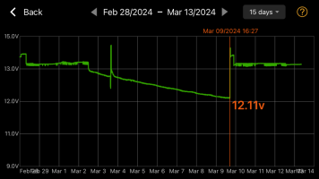

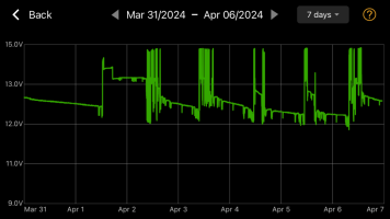

Plot from BM2 showing full charge 2nd March 13.3v (battery on charge for 4 days), dropping to 12.11v by 9th March with the van locked and left alone.
Then something hopefully interesting - we had a 5 day trip away last week for which the leisure system was reconnected and we didn't charge the vehicle battery other than by driving each day. The plots from BM2 show;

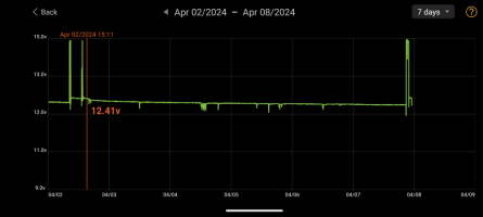

5 day driving plot shows battery charged to 13.3V before we set off 2nd April, camping in the van each evening/night so doors open & closed etc, van hooked up to electric supply each evening to charge leisure (only). Driving for 159 miles on day 1, only got 12.7v when we stopped, charging only from the vehicle alternator, less on subsequent days when we covered less distance.

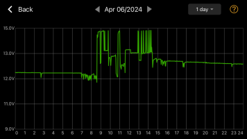

6 April plot shows our return journey, starting at around 12.1v, we drove for 5 hours or so, covered 250 miles but the vehicle only charged the battery back to 12.7, nowhere near the 13.3 we get from the Victron Smart Charger. Haven't shown the plot for today but at 18:00 on 8th April, we're back down to 12.33v.
As a general observation the MOLL EFB batteries have a bit of bad reputation, they have not been very reliable. You might want to consider moving to an AGM battery.
If you are a 6.1 then you will have Start Stop so remember that your van will generally only charge to around 80% (it leaves capacity to do regenerative braking) but the Victron will charge to 100%
If your 12.7 figure is from a point the battery is reasonable unloaded then that would be about that region - an EFB battery follows an AGM voltage profile.
I assume your start stop is functioning? (It's a good sign of general health of the system) your smart alternator appears to be, hence the spikes of near 15v charging

Looking at your graphs, there's definitely either a drain or the battery is knackered.

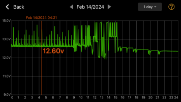

Here's mine on a T6
12.4v after a 25 min drive from work, 5 and a half days later with zero driving and it's only dropped to 12.24v.
Let's run some numbers. In your March plot you got to about 55% charge using the AGM values, and I suspect your starter is 70Ah like mine.
So that means, assuming full capacity, you've lost 38.5Ah of capacity over 7 days. That's 5.5Ah per day.
That's an average current of 0.23 amps
That's not actually a huge amount it's not inconceivable that a tracker could do that, it does feel a bit high.

Looks like you have a problem, the starter battery is being drained at a constant rate.
It's running flat over 7days.
Id assume the tracker may be the cause, but possibly other items as well?
Usb charger? Dashcam?... Anything else non OEM installed?
To test you can pull the fuses for the tracker for a few days, then plug back in for a few days... Then post the bm2 plot.
