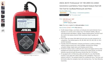

Also you can test the battery at Halford or get a test meter yourself ( works on all SLA batteries)
I've got a couple of battery testers, this one works well and is nice a small to keep in the van . . . . . . .
ANCEL BA101 Professional 12V 100-2000 CCA 220AH Automotive Load Battery Tester Digital Analyzer Bad Cell Test Tool for Car/Boat/Motorcycle and More
  • Small compact design, scan faster and indicates test results directly. Even a beginner can use this unit to analyze any 12V batteries healthy, tells you everything about the battery: voltage, charge,cranking power, and how much life is left in the battery (level of Ohm resistance). Does it quickly and precisely.
  • Much wider test range (100-2000 CCA) and more accurate compared to its competitors. Test results based on JIS, EN, DIN, SAE, CCA, BCI, GB, CA, MCA and IEC Standards.
  • Provides check the Alternator's charging and Starter's cranking conditions. Vehicle charging system test is also available, including load voltage, unloaded voltage, ripple status and charging system status.
  • The BA101 battery tester is well built with a large LCD display that has white backlight and contrast adjustment, indicates test results directly. no internal batteries required and gets the power directly from the 12V battery.
  • It's equipped with a 3.0 feet long cable and made of a very thick flexible insulator, much safer than others selling on the marketplace. There are 4 buttons on BA101, The up/down button for scrolling the menu. The Enter and Exit button allow for navigation back and entering menu. Two Years Warranty Guarantee.
