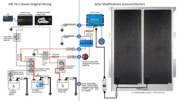

On the other hand if you want a fag packet/paper napkin diagram then here's my setup...
Haven't shown the neutrals but this works for my camper, ask questions as there is more than one way of doing off grid electrics.

After doing this I came up with the following system design for my Ocean.
... and here it is fitted ...
Solar panels fitted to a roof carrier ....
Wires routed alongside the LED light wires in the pop-top
MPPT, breaker and fuse in the top of the rear cupboard.
Argofet battery isolator under the passenger seat (LHD)

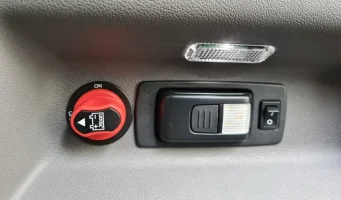

Switch to charge the starter from solar when parked up.
Display to show solar charger power etc. (not needed as it is all available on a Bluetooth App).
... this system covers MY power used adequately so in the summer I don't need any electrical hook-ups.
