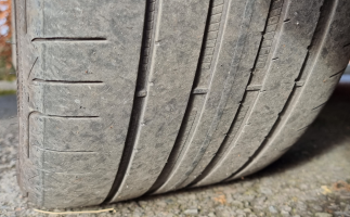

So, I could do with some advise with regard to tyre wear with reference to the image below, the pattern would suggest over-inflation but I'm running between 36-38 Psi (tyre machine reading at BP) so am a little confused as I thought this was good. Thanks in advance!
Tyres have done about 10K miles, middle measurements 2-2.5mm, edge measurements 4-4.5mm, both fronts are the same, rears are worn less and are both the same.

Everything about this pic is counter-intuitive!
The tyre face/tread appears to be concave yet you're quite close to the wear indicators in the middle. I'd also expect that "seam" in the middle of the face to have worn off by now. The tyres don't look like you throw the van through roundabouts/corners either.
Maybe visit a trusted tyre fitter to have a look? He could also check your tyre pressures with a maintained air-line rather than relying on supermarket/petrol station ones which are abused.

I completely agree with your observations, I was also a bit confused by the middle seam also, hence why I posted here.
I certainly don't throw it about, so you're correct there! I will have to double check the pressures with decent machine I guess.
The first set of Avons I had on mine wore just like that. 255-45-19. I found that 36PSI was the sweet spot too. I think that unless you fit rock hard, never heard of tyres, 10-12k is about all you'll get out of larger diameter wheels and tyres. Despite being load rated, I really don't think that what are essentially SUV tyres, are best suited to fitting on vans.
