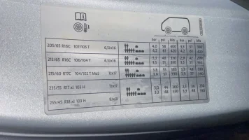

The top tyre pressure plate is from my T28. Max axle weights are front 1600kg and rear 1550kg with max mass of 2800kg.Would like to know your max permissable axleloads and vehicle loads. Can be found on VIN plate somewhere on car, I is front , II is rear.
The lower pressure behind then front, indicates lower MPAW rear then front.
For vans its mostly higher rear then front, then plate is wrong. I think they placed the van-image above, the wrong way around.

Here is a tyre plate sticker from a Cali for info:OK, so help me out here pls -)
I've a T32 LWB T6.1 DSG 150ps, camper conversion, its got 255/45R18 103Y XL tyres on it (just to be replaced since rears are really worn on the outside corner).
The van I weighed when touring Italy, it was 2560kg with 2 pax and loaded up with camping gear and luggage. With one pax, with all the camper conversion stuff its going to be about 2450kg, which is probably 70-80% of use cases.
I've no idea about the loading on each axle. The van only has a tyre loading/pressure sticker for R17s. I've tried various tyre pressures, currently sitting around 44psi on each corner 9got that from the CamperKing conversion website). Which may be too high given the above?
Any opinions on what I take as optimal tyre pressures ? Any thoughts before I put the new tyres on?

Pax is just an abbreviation for passengers. maybe not used in NL?What do you mean with 2 pax and 1 pax.
ok thanks. pax= person. So normally when I drive alone + stuff, load would be 2450kg. Wife+luggage= 2560kg max.. And I wouldn't go more then 99mph!Then first I dangerously estimated your axleloads for 2560 kg, to be between 1250 and 1350 kg .
This would read in my list for exact the same tyres as you have, between 33 and 36 psi.
Yes that low if axleweights are right estimated.
Then max speed 160 kmph/ 99 mph wich you wont go over for even a minute, not that difficult to hold you on, I think.
And max reserve at wich comfort and gripp still acceptable.
The sidewear on one tyre is an alignment thing, so let it checked when changing tyres.
Hope rear can be alighned.
