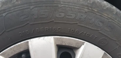

Hi need to replace my 2 front tyres but I'm getting slightly confused as to what my load rating is. is it the 106 or the 104 T also what is the 102H in the circle? 20180720_195246.webp
Hi need to replace my 2 front tyres but I'm getting slightly confused as to what my load rating is. is it the 106 or the 104 T also what is the 102H in the circle? View attachment 25859
The load rating of the tyre is 106 when used as a single. 104 when used as a dual. T is speed rating (190 km/h, 118 mph). The circled 102H - don't know :unsure:.
Load rating 103 (875kg) would suffice even on T32 (requires 860 kg).

many thanks for your reply...now time to start pricing up
