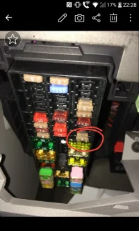

In the fuse box under the gearstick, there are 3 rows of fuses at the top.
Right hand row, the top bunch of fuses are the smaller type. Pull the lowest one. It's for the ESP.
You'll get warning light. Warning will reset when you put fuse back .
