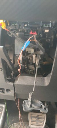

hello guys , i need help if you can into installing & coding TPMS SET to my tiguan 2018 >>> i bought a tpms system pack from AliExpress (Module& 4 Sensors & harness )
first problem i faced that after research i found some guides did this installation by connecting the two wires from tpms module to the socket under steering wheel and some others said it should connected to getway canbus module ??? which one is right ? or its depend on car model ??? if i get answer and it will work there will be another episode about codding :) :)
