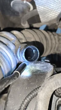

  • The heat exchanger cooling hoses are deteriorated/damaged by oil = will rupture at some point.

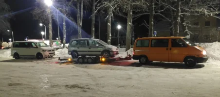

The setup
-20°C + dad's old car on a trailer.
The result
T4 always gets the job done! Had to leave the T5.1 midway there.
