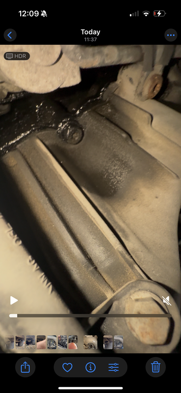

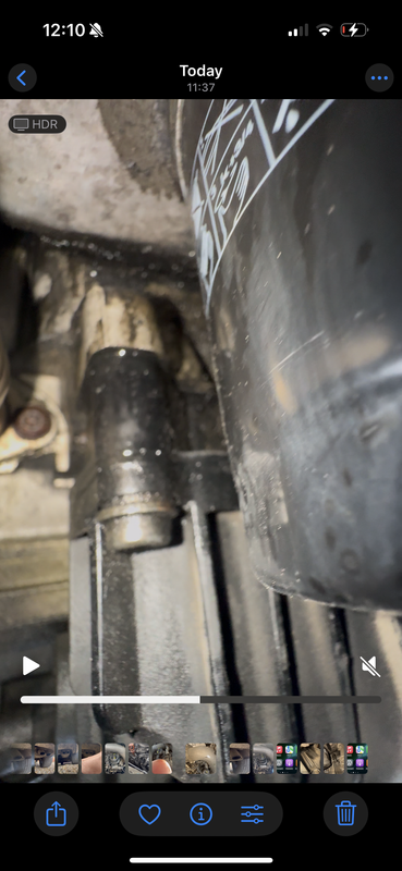

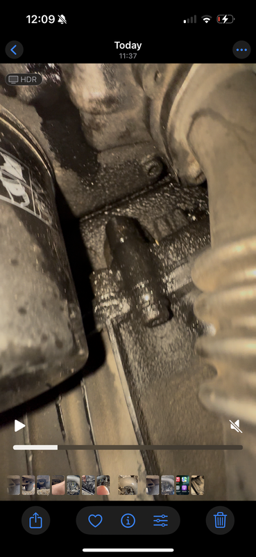

Cleaned up the area of oil leaks and then took for a spirited drive. Mostly seems to be stemming from the intake manifold and dripping down. Seems to be some sort of pcv issue, I’m hoping this isn’t because of bore score but probably quite likely.
Removed what I believe to be the outlet for pcv/ccv. No signs of cracks in the pipe. Under revs no real mist and no oil splatter which I wasn’t expecting. Inside of the pipe lightly covered in oil.

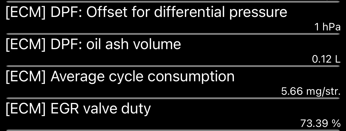

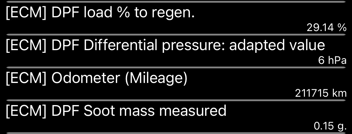

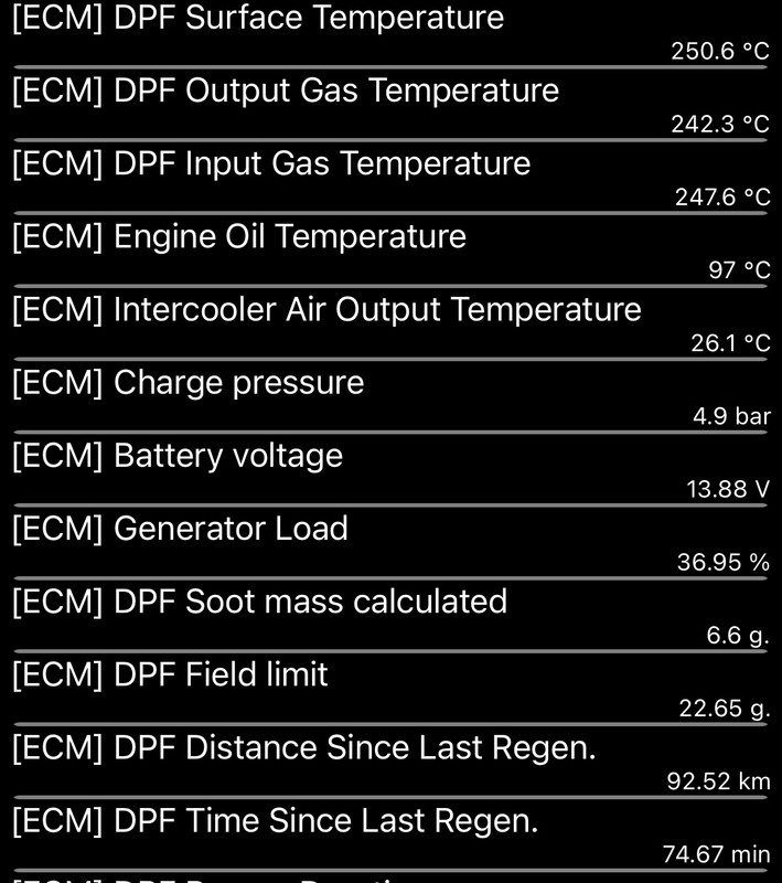

It’s not looking too good. Have you got Carista or similar to monitor the DPF and re-gen’s?
