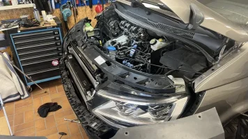

I went ahead and did the thermostat to rule that out. Annoyingly The old thermostat worked fine just a little sluggish compared to a new one.
You need some balls to crack open the housing without a spare part to hand. It turns to the right and there’s a pin on top locking it. It opened without releasing the pin or breaking it. You need the car in the service position to do the job.

The thermostat needs to be changed with the thermostat housing because it isn’t easy to reseat the thermostat once it’s removed.
A new housing and pre installed thermostat seems to have solved my issues
Reactions: mmi
Oh dear, I’m going to have to also admit I think that febi 106524 thermostat doesn’t fit that engine. I thought I triple checked it and on some sites it says it’s compatible but I just went back to Febi’s website and they don’t list a thermostat for the sg vans. With the febi thermostat fitted in the old housing I can blow air through. With the old original one I can’t. So maybe with a different manufacturer it might have been possible to just change the thermostat.
