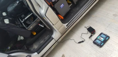

Would a power generator have enough stored power to re-charge a 110ah Lead/Acid battery?
I already have the GB70, (Black Friday sometimes has some bargains!) but the only way I can see to connect it to the leisure battery is using the crocodile clamps, my leisure battery is under the drivers seat and is not that easily accessible.
Would you advise safely adding cables to the leisure battery that I could attach the GB70 clamps to without having to disturb the drivers seat to connect the Noco?

I would use 2 mm cable and fuse it at 15 amps. Standard 20 amp rocker switch. Remember, this is only to raise the voltage on the battery terminals, not for supplying power.

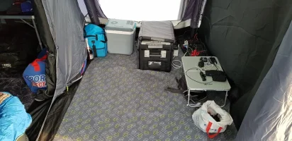

i looked at them, watched a few vids etc . . . then went for a 110Ah AGM Extreme battery + Box + small 240vac inverter. which sees us through a few days running the fridge and lights . . you can see all that good stuff over here > Kit List And Stuff -- How I Done It & What I Use --
But in regards to the first post my first thought was the same as Travelvolts . . . . . You already have the ability to recharge your battery at a decent rate from your Ablemail AMS 121230 by running the engine etc . . . . so i was thinking Jump pack. seeing as you only need to fool the Ablemail into thinking its ok to charge, and you have the NOCO . . .
So, you have the GB70, so why not just use the 12v output to plug into a 12v socket thats already connected to your Leisure battery?

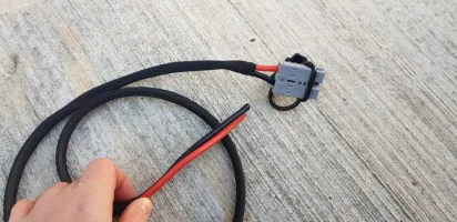

or my personal preference Anderson plugs . . . you could have one fitted to the Aux battery, tucked under the seat (or wheresoever) that can be used as a battery point to charge or pull power from the battery. (120A anderson plug + 80A Maxi fuse & holder + 10mm ring terminals - Kit List And Stuff -- How I Done It & What I Use -- )

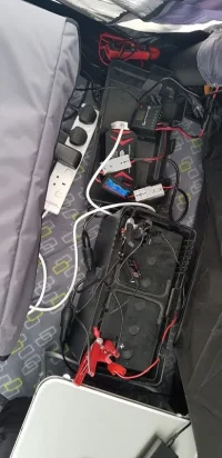

@Dellmassive I also like the additional battery and inverter idea, could you be more specific in what you used and how you built the individual parts please (any photos available)?
Did you have a UK 3 pin socket wired to the inverter? This could allow direct connection to the EHU socket.
- sure , see below.
- yes see below.

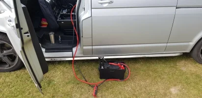

Basically we used a large AGM battery in a battery box, with a small Pure SINE inverter, and a 4way extension lead . . .
Dellmassive`s -- "how I Done It" -- Thread
so we used a box like this: (the box shown in the photo doesn't fit the Xtreme XR1750, the one that fits is the NOCO Group 24 -31 Battery Box HM318BK)
with a battery like this :
and a small inverter like this :
BESTEK 300W Pure Sine Wave Power Inverter - https://amzn.to/37UVR8w
using this type of connector:
BESTEK Battery Clamps / Socket adapter - https://amzn.to/2RMudVi

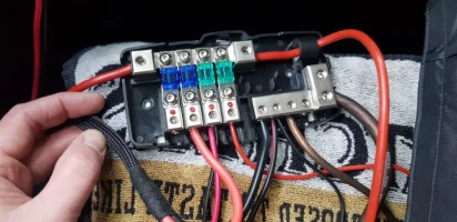

and this type of fuse & Holder:
you can see all the bits on the kit list here > Kit List And Stuff -- How I Done It & What I Use --

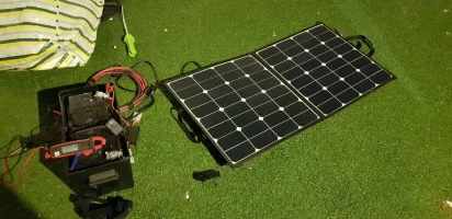

you can see thge box in action over here> Mobile Solar Panels ? . . . - How I Did It -
we used mobile solar to keep it charged (during summer time)

Thanks to all for their help and suggestions, I now have to decide which one, or more, I will go for.
The photos helped greatly in understanding the versatility of the second AGM battery/inverter set up.
Just ordered the battery and box from Alpha Batteries, please note that the box shown in the above photo doesn't fit the Xtreme XR1750, the one that fits is the NOCO Group 24 -31 Battery Box HM318BK.

Looks great, remember to add a fuse to that battery +ve if you havent got one already.
MIDI style 10/20/30A.
