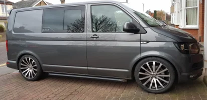

Ok... I've just had some new tyres on so thought i would show a pic to help other see what this size looks like on...they are 265 x 40 x 20 with a 104 load raiting and i have around a 70mm drop on B14's
i have had a couple of very faint brushes of the fronts on the arch liners if i hit a big pothole but under normal driving and on full lock no problem at all.
