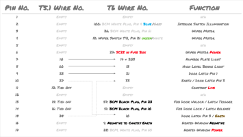

Hi there I’ve just done this conversion from t5.1 barndoor to tailgate. The lock / handle you’ll need will be specific to the t6 tailgate. Your latch maybe the same if you have any pics that’ll help.Hi im just attempting this conversion. Fitting a t6 tailgate to my 2009 t5 factory tailgate van. Did you manage to get this done? I thaught my hinges would bolt straight to new door however the holes seem to be offset on mine where as on t6 tailgate the holes are in line. So im after a set of hinges now but once I sort that im wondering how best to go on with the lock/latch? Cheers

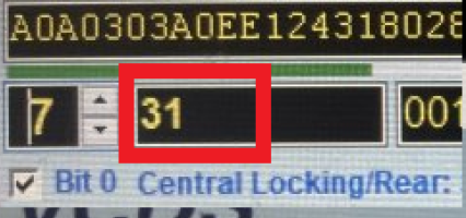

Click on LCode2 - should open all/undocumentd tickboxes.these two options aren't present in VCDS for me.
I would try changing byte 2 (value now 30) to value 39 (hex).I suspect this is the coding specifically for a T6 and wondering what it should be for a t5.1. I
Byte 01, Bit 7 was already ticked and active. It's Byte 01, Bit 5 thats missing. I'll need to arrange another visit to my garage as they were kind enough to let me play with their VCDS.Click on LCode2 - should open all/undocumentd tickboxes.
Anyways, the byte 1 is already correct (A0) in the picture.
If that doesn't work, please post scan section for the BCM (in plain text as it makes easier to do comparisons).
Ok, I'll give that a go next time I get to play with this. thx.
Byte 01 is already good to go - no need to tweak it. The bytes (EDIT: typoByte 01, Bit 7 was already ticked and active. It's Byte 01, Bit 5 thats missing. I'll need to arrange another visit to my garage as they were kind enough to let me play with their VCDS.
Getting some time to get back on this. You referred to Bytes 02 and 03 in two separate replies. You suggested Byte 02 Bit 30 needs to be changes to Bit 39, but no mention of changes to Byte 03. Was that a typo? If not, can you confirm which one needs editing via LCode2? Thx KennyByte 01 is already good to go - no need to tweak it. The bytes 03 and 07 need to be adjusted.
If individual not-shown bits need to be tweaked, the LCode2 opens them all for editing
Good catch - indeed the bytes 02 and 07 need adjusting:Getting some time to get back on this. You referred to Bytes 02 and 03 in two separate replies. You suggested Byte 02 Bit 30 needs to be changes to Bit 39, but no mention of changes to Byte 03. Was that a typo? If not, can you confirm which one needs editing via LCode2? Thx Kenny
Sweet, thx for coming back so quickly. will give this a go and let you if it works.Good catch - indeed the bytes 02 and 07 need adjusting:
Byte 2 > value 39 (hex)Byte 7 > value 11 (hex)(no change in byte 03)
Did yiu manage to source t6 hinges ? Can you confirm they are different to t5.1 hinges as I'm now having the same issue cheersHi im just attempting this conversion. Fitting a t6 tailgate to my 2009 t5 factory tailgate van. Did you manage to get this done? I thaught my hinges would bolt straight to new door however the holes seem to be offset on mine where as on t6 tailgate the holes are in line. So im after a set of hinges now but once I sort that im wondering how best to go on with the lock/latch? Cheers
The T5 hinges fit the T6 tailgate i have just trial fitted mines, the only thing is that there is no adjustment available with them which wasn't a problem because it all lined up perfectlyDid yiu manage to source t6 hinges ? Can you confirm they are different to t5.1 hinges as I'm now having the same issue cheers
@mmi Hi I'm completing my T6 conversion and struggling with the coding and mine doesn't match anyone and
this is my current coding -
A82CA1BA0A61343192284E106E6B9C55008071FF60860040320000000800
