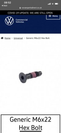

It's these bolts you'll need for the recessed roof rails, I've just bought some for spares while working out best way to fit an awning rail to ours.
Have a look at how many bolt holes are on the roof roof your van though, if it wasn't supplied from factory with the 'Roof Load Preparation' option, then there won't be the same number of fixing points.
