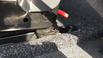

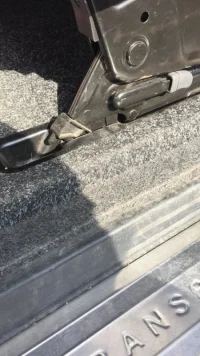

They dont look like the transporter 2+1 seats in the pics . Can you take a pic of the floor mounting brackets please :)?
Definitely not OEM seats.
Sorry what are OEM seats?
I’m just trying to get some pics of the floor brackets.
Unfortunately they don't look like the factory seats , what sometimes happens is people will install seats from a different manufacturer van like ford or Renault as it's cheeper to buy they seats and floor brackets , down fall is if is definitely not vw seats then you would have to find out what manufacturer they are then look for the folding versions of them , hope that made sense . Tryn get a pick of the brackets to see if there similar to vw vw have a feeling they aren't
