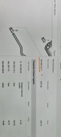

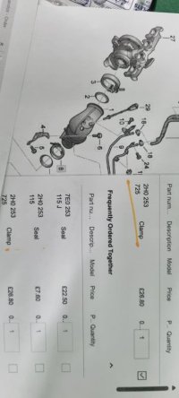

Hi. As I can see on picture, you didn t clean dpf. You clean SCR/adblue.
