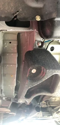

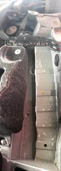

I have a 2016 T6 Euro 5 with an 80L fuel tank, there is space for an Adblue tank.

These aren’t the best photos but you can see the polystyrene taking up the space the Adblue tank does, along with the space within the passenger step.

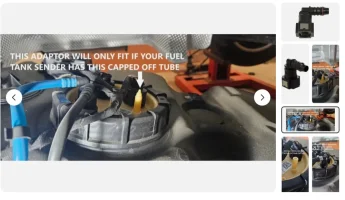

Thanks buddy, yes it’s still an option, especially as I have now seen that some vans have a “blank tube” on top of the fuel sender that can be used (with an adapter) without removing the sender unit.
I will probably still have to lower the tank to see if I’m lucky enough to have that version 🤔
Thanks Buddy, that’s really useful, I’ll have to jack mine up and remove the panel to reveal if mines the same, when you say you would do it differently given the chance, you said you would have the vent exit the base towards the passengers, do you mean the front passengers (perhaps to heat the cab first) or the rear of the front seat towards the rear passengers🤔
