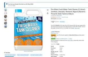

@Dellmassive (Big Bro) has suggested that "Pro-Kleen Fresh Water Tank Cleaner" & "CleanTabs Puriclean" are the favoured products for disinfection in the group, both appear acceptable as they both claim to breakdown and prevent biofilm.
