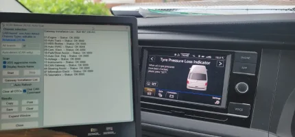

Just got around to doing this after years of owning it. It worked for me but I had to do what sam_watson did with the l2 coder to get byte 0 to work and be able to reach the higher byte's.

Hi everybody,
In the end I additionally (to the mentioned coding) needed to remove TMPS receiver unit fuse (nr. 52 I guess). Otherwise it always goes back from "indirect screen with SET button" to the direct system screen with 4 tires pressure screen...
