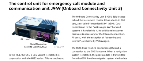

It's shown as behind the instrument cluster for LHD vehicles
Physical looks like this
