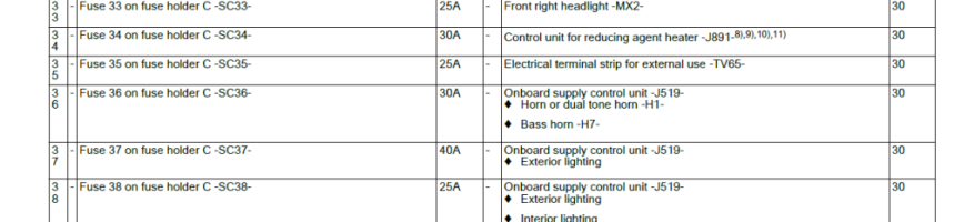

Lets reverse again, just looked at the fuse charts and wiring diagrams and it looks like it is fed from fuse SC36 which is 30A (please double check) and wired in 2.5mm cable so should be good for 18A
2.5mm thinwall cable is rated for 28A
