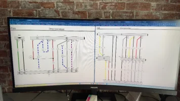

Good day everyone, I don’t drive a T6.1 — I have a Polo. I’d like to benefit from your experience; I’ve read all the comments, but I have one issue with the wiring. In the Polo wiring diagram, the functions of the wires aren’t specified, and I’m a bit concerned because in the Golf diagram the wire colors are swapped around. Could someone please help me with this?

The BCM in the Golf 8 is different—it includes steering control, which we don’t have.IMG_6808.webp
