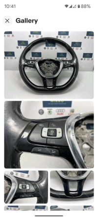

I have 2019 euro 6 Trendline with the basic plastic steering wheel with no buttons, but I do have the ACC on the stalk.
I would like to know if I can do a straight simple swap for a wheel from a Mk7 Golf and have the airbag, horn and ACC on the stalk continue to work normally? (I'm not bothered about the buttons on the replacement wheel working, they can be just for show)
Photo below of the type of wheel I'm looking at (it has ACC buttons on it, but I'm hoping I can continue to use the buttons on the stalk instead)

It sounds like you’re effectively swapping over a wheel for a wheel, regardless of the electrics on the stalk, so I can’t see a problem with what you’re proposing.
Just swap out the trims so you get the blank steering wheel trim from the Trendline
and your old wheel gets the buttons + wiring from the Golf, and sell it on.

Thanks for the welcome and for your answer.
I agree that it seems like a simple swap and I hope it is, but I got the impression from another post on here that trying to use a wheel with ACC buttons would be problematic if fitted to a van with ACC controls on the stalk.
I don't believe I could swap anything besides the airbag from my current wheel as it looks like one moulded piece, so I would have to keep the buttons on the replacement wheel purely for show (photo of my wheel below)

I’m sure I’ve seen a post on here where someone with Trendline said that the blank parts was a trim.
Getting buttons coded isn’t impossible, even if you just fit Euro5 buttons so it’s all headunit related and not cruise-control.
You’ve probably seen it here:
Also, if you’re going for looks only, I’d definitely go round and not kidney shaped (just make sure your replacement wheel comes with the airbag, as there are two types depending on the shape / hooks)
I have seen that post thank you. But I'm not bothered about the buttons working, just the airbag, horn and ACC on the stalk.
I'm happy with the kidney shaped airbag to be honest. It is for looks, but mainly for a better feel than the horrible standard plastic.
this button blank is what I was getting at:
Or this pattern part:

Hi Mate, I bought it from eBay for around £80 and it probably took me around 20 minutes to fit. The only slightly complicated part is removing the airbag, but there are videos on YouTube showing how it's done.
No worries, the only other thing to mention is to make sure you have a spline bit to remove the steering wheel nut. I bought the set from Halfords
