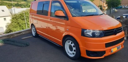

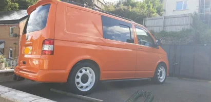

Defender Steels and General Grabber AT3 235 55 18 Straight bolt on and a bit of easy fettling with the centre caps. IMG_20240425_131435.webp
Yep....I used the same. No idea if theres an alternative but been on 2 vehicles with the same bolt, 70k miles and no issues.

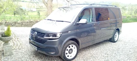

Hi Danny. I've just fitted some defender steelies to my t5 using the t5 bolts with the built-in washer, but the tyre fitter said they might not be the correct ones for the LR wheels. Which ones have you used?

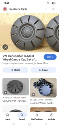

Are you using VW center caps with them?

If you're using the one's with the rectangular slots, I think you'll struggle to get enough off the edge for them to fit before you reach the rectangle. If its the circular holed one's then that's what I have and so I know you can achieve enough off....if you're right handed, I found it best yo use left hand bias tin snips...and visa versa if you're left handed. Really neat cut and needed just a light run around with sandpaper afterwards. A bit if sika on the nuts and they were solid.
Yes, the all black ones with slots. I was looking at them just now thinking there's not much meat to cut off before the slots would reveal. Hopefully won't notice it too much when they're on. I don't have the luxury of curved snips, only the common or garden straight jobbies 😄
I think someone was selling some chrome centered ones with the circular holes...just in case you bugger yours up...:oops::eek:
