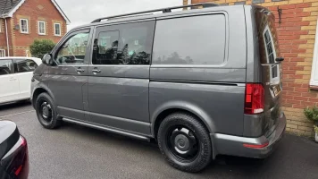

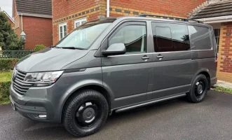

Oh that's very cool. So are they the Land Rover wheels 18"
Yes, banded to 9" fronts and 9.5" rears.
Always loads of sets of them on Facebook Marketplace for very little money.
Straight fit apart from needing a spigot ring

What size tyres are you running, they do look very smart
