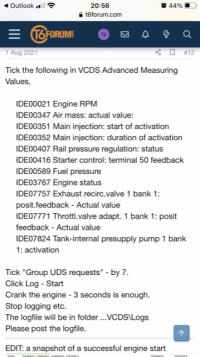

1) Perhaps you could do a recording described here:
2) A VCDS Auto-Scan would be helpful
3) Also full engine measurement block data might be useful - described here:

It seems your dongle is of older generation as it didn't create the huge blockmap data set in step (3) (file blockmap-01-04L-906-056-KG...? An example how the file looks here --> Won’t start [Resolved]
