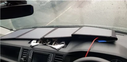

Bear in mind that the windscreen tinting massively reduces the power output, so minimum of 50W I would say.

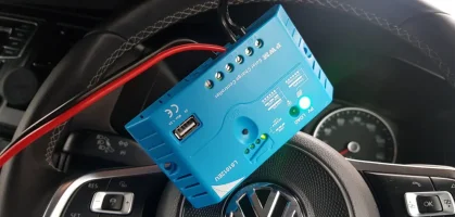

Definitely use a controller - you don't need to spend much.

I tried to use 40w on the dash of my T-Cross whilst lockdown was on - not good enough. I then used a 100w panel that just fitted across the dash which gave enough juice to keep all the electrics ticking over whilst being used. The screen does cut down the output considerably so I don't know that the 50W would do the job even. ( I used a cheap £40 100W panel from an offer that I spotted on Amazon)

PWM is functional . . . but MPPT will give you more yield. . .
The Victron is the best-of-the-best - but also offers fantastic monitoring, so you can see / meter what you are getting.
i use a 50w dash panel starter trickle charging . . . . .

here is my 100W on the dash:

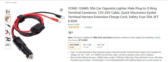

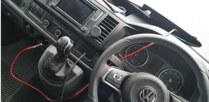

You can charge the starter battery directly through the cigerette port?
So long as the charge current doesn't exceed the fuse rating of the socket, yes, it stays connected when the van is switched off and keys removed. Don't leave a 12V/USB adapter in it or it will flatten your starter battery in about 2 weeks or less.
yes. . .
but keep the current below 6A/8A or the plug & socket will get HOT.
a 50-100W dash panel is ideal. . .

In a T6.0 I believe you can. However, in a T6.1 with a factory-fitted second (leisure) battery, owners have found that the two sockets in the cab are fed from the leisure battery. This means that with a T6.1 you’ll have to connect to the starter battery under the bonnet or pick up the feed to the Split Charge Relay under the passenger seat.
If you’ve got a factory-fitted tow bar, trying to charge via the tow-bar electric socket will only work if you’re happy to do some hacking to fool the controller into believing that you have a trailer connected.

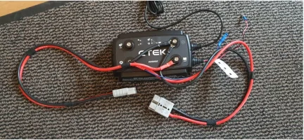

I've tested the Jackory portable power box + 5A charger too. . .
What about with a retrofit DC-DC Charger? Would this charge both batteries?
DC-DC chargers are more powerful, so need direct connections to the batterys. . .
a dc-dc will charge the leisure battery when the engine is running, (starter is also charged when engine running)
but I've done it using quick disconnects - ie SB50 Anderson connectors.

I see you went for a CTEK, I was looking at the Victron products mainly..

I've tested numerous DC-DC chargers.
i wasnt overly impressed with the CTEK D250 range - if i remeber i called it "a good safe bet"
i now used the Victron XS dc-dc in both vans,
