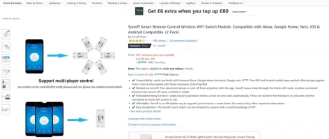

@True Romance
I've been using the SONOFF kit for a while now, its got a great following and works reliably, the APP is easy to use . . . . (just be carful when changing wifi routers !!)

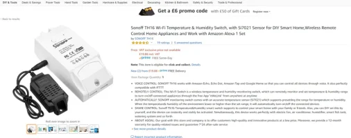

anyway i started with the 240v WIFI switchgear..
The TH16 is a 240v WIFI switch with Temp & Humidity that i used to monitor the shed for . . . . . well temp and humidity....
i had it inline with a dehumidifier and greenhouse style heater to keep the shed from freezing and going moldy.

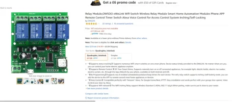

They also do a 240v 4chnl version called the 4CH R2 (again 240v)
https://amzn.to/37GFrA0

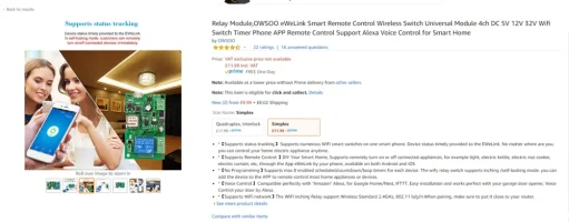

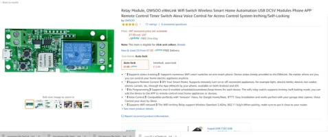

moving over to 12v & USB we have these versions..
7-32vdc or USB single Chanel
https://amzn.to/2QRageh
and the 4chnl version . . .
https://amzn.to/2QtBmcH
also a straight USB single Chanel version . . .
https://amzn.to/36sNkJb
so I've now got the shed running one of the 4chanl versions that is switching the 12v LED garden lighting . .
3x separate chains that can be switch manually or via timers set on the phone APP.
The whole lot is fed and powered from the battery bank.

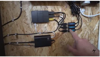

Using the cables:
each Victron VE Direct unit needs its own USB cable.
connect wach cable to the Rasperby Pi thats running The VenusOS firmware
connect to the VenusOS via the Victron connect app via Bluetooth or WIFI.LAN
So
BMV712 -> #1 VE USB cable -> Rasperbery-Pi
Victron MPPT -> #2 VE USB cable -> Rasperbery-Pi
Victron Inverter -> #3 VE USB cable -> Rasperbery-Pi
Raspbery pie can be WIFI or LAN (PI 3B+)
Raspbery Pi possibly connected to cloud via Victron GX GSM ? - untested yet.

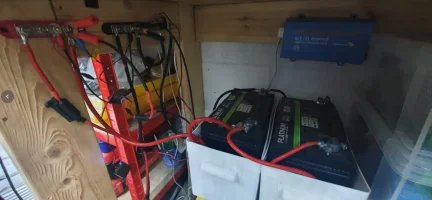

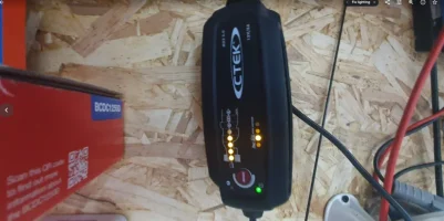

were chargeing this battery bank:
2x SLA 110Ah Leisure batterys.
with this solar controller . . Victron 100/20
via these bus bars . . .
with this monitor & Bm2 . . .
inverter wise we have two to play with . .
here is the last days BM2 readouts . . .

well we have finally reached that time of year. . . . . Not enough Solar power to keep the Garden/shed 12v system topped up. (Dec 2nd 2020)
i come out this evening and all was dark and cold =[
lets see what happened:
The BM2 shows 8.0v across the battery bank,
lets look at the history to see what happened . . . well start on the 26 Nov 2020 and move forwards to 3rd Dec 2020 so we can see the system fall flat.
This is the MPPT 100/20 log shoing the decline:
and the BMV712 after a full EHU charge:
So it was time for a EHU charge . . .
connecting the CTEK MXS 5A we have this . . . .
this is the Victron VRM portal log for the last 6 months . .
you can see from the charts that we start to loose the ability to fully charge the battery bank from around the start of November . . .
