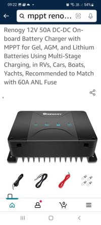

To charge that you will need a dc-dc charger.

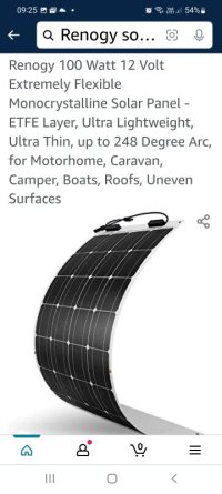

Then get your two flex solar panels....

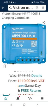

Then you will need a solar controller.... Victron is highly recommended.
