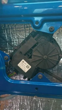

Right, wish me luck, it's booked in to VW on Thursday. I've pulled the door card off to make sure none of my insulation or sound deadening is tangled up in the cables (it's not) and to check plugs are all secure (they are).
Soft close motor appears to be dead but I'll be very embarrassed if it's a fuse somewhere (that I haven't been able to find).
Pic of naughty motor and the gibbons it's supposed to be actuating:
Edit: yes I know the gubbins isn't plugged in when I took the photo 😁
What I could really do with knowing is if the soft close function has a fuse, suspect it doesn't ... everything else is working.
So apparently it's the door control module which I think is above the rear wheel arch near the sliding door motor. At least it wasn't just a fuse!

OMFG still not fixed, but at least they're quite good at updating by phone. Sounds like they've replaced the door module, now they're waiting for the soft close motor to arrive (tomorrow).
