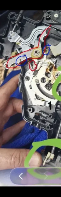

Hi, thanks for reply, long story! The solenoid on the sliding door was intermittently not opening. It would always lock. Same as my last van. Cleaning the door contacts didn’t help. Persistent locking and unlocking, pumping the handle and the odd thump always gets me in! Current van also won’t open from inside. But this weekend I thought I’d take a look. Seems like the cable to the rear lock had stretched it was pulling but not quite enough. I partially fixed it by removing the bar attached to the handle, heating it up and twisting it slightly so that it rotates the reciever port just enough more to open the latch. Then I went into the lock mechanism and messed something up because now once locking and then unlocking the interior handle does nothing. If dig my hand in and pull on the latch mechanism the door obviously opens but it also somehow resets the interior handle to work everytime but only if the van is unlocked. Inside the mechanism there’s one spring at the bottom that I can’t figure out where one end goes, I’ve found 1 picture online of someone who opened one up where you can see the spring and both its locations (circled blue) but it attaches to a bar and another small rod that I don’t have (circled red) and most definitely didn’t drop when opening. So I’m giving up and buying a new one. Exact match is around £300 but the ones with BQ are cheaper, it seems like the only difference between BS and BQ is a child lock but I’m not 100% sure.
Just to add the sticker with the part number covers a screw and it was intact before I opened it therefore I don’t think anyone else has opened it, plus the bar couldn’t just fall out as it would be still be attached by the rod to another part that I have. so I’m convinced mine doesn’t have it. Nothing fell apart except for the spring I haven’t rebuilt it. But I’ve tried that bloody spring always round.
And thanks to who posted this original pic on a facebook page, as you can see it holds position when opened correctly.
