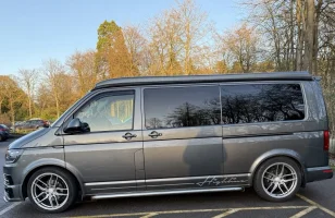

Anyone running Black Rhino calicos?
I’m looking at getting the gun metal grey ones.
Currently running 20” bolas on nsl suspension. I want something a bit more practical for comfort but it still needs to look right. Pictures or opinions welcome
Just something to be aware of, that stock rim photo won't be the correct offset and therefore dish as the T6 fitment.
I'd say on a T6 they don't look that great - although it's hard to say what size tyres are on this one
