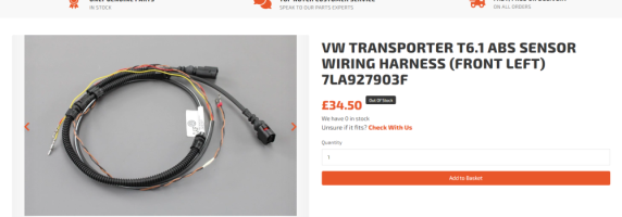

this bit?​
VW TRANSPORTER T6 ABS SENSOR WIRING HARNESS (FRONT LEFT) 7LA927903F​
not really . . . £40.46+vat
£48.55 with free delivery lol
that's a fortune for a bit of wire and a few connectors. . .

Yes I was hoping I was buying a smaller/cheaper part :D No loss for you at least, excluding Partshaus who are cheaper, they all want £50+
a VAG Tech i was chatting to said you may be able to by the connecter and the two repair wires.
that will be cheaper. . .
but dont know the part numbers to check . .
VW gave me that LOOM number when it went into them - so thats what they were going to replace.
ill just do it myself . . . . . . at some point.

The loom goes up to the ABS module....so the OEM repair is to repin the connections and run a new cable.
But the shortcut is to cut out the the cable at a suitable point and splice in the new section in... Ie solder and heat shrink. Or crimp and heat shrink.(I'll prob do this)

hi, has anyone actually completed changing the loom? The wires snapped where the pad sensor connector is on mine. I’ve bought the genuine loom same as above but couldn’t locate where the individual cables push in? I’ve had the battery out and the tray trying to follow the cable, must of spent 2 hours trying to trace it. I’m half tempted to cut the new plug off and solder the cables.
they go to the ABS module. . . and loom join in the E-box
pad wear sender seems to go to the dash panel insert. G34/G37 ---> K - via loom
G34 front left wear sender wires to T10J/5 yellow . (10 pin con` dark brown in E-Box)
G34 front left wear sender wires to T10j/4 red (10 pin con` dark brown in E-Box)
ABS wheel speed sender - front left.
G47 - brown T38a/36 - wires to N55 - ABS pump
G47 - black T38a/37 - wires to N55 - ABS pump
I thought the solution was to solder in the wire connection with the new sensor connector and put some tape or heat shrink on it. Rather than coding it out, twisting the two wires together will cancel out the warning light
Now I’ve spent £40 on the loom id of like to change the whole thing really I looked in the fuse box under the battery, I was abit overwhelmed by the amount of cables I couldn’t make out which cables I needed or where the cables connected. The last resort is to cut the connector off and solder it onto the existing loom.
I’m not convinced it is a “last resort” as I suspect that is what a stealer ship would do too! There is a reason they produce a fix…..erm, they know they have a design flaw!

I recon I'll be splicing the connector in at some point.... Not sure I fancy pulling the ABS and ebox looms apart.

Splicing is the way to go! Save yourself a load of grief!!!
