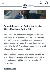

Looking here...
...it appears to include the 2 year service plan for vans 0-12 months old.
I was looking at using the Oldham van centre, not heard anything bad as it's quite new...... but that doesn't mean its good
@DazS did you put your van details in? Last Autumn on the 20% sale I bought a service only plan for my then 18 month old Caravelle with the same discount.
I can't check myself directly as I now have an active plan, but I can't see anything in the advertising that says the 20% is All In only, so maybe worth a dig.

For your van right now it's not an option if you are under 3 years old as you have remaining factory warranty, but you can get a standard 2 year service plan.
Keep in mind that while that plan is active you can't take out another one including the All In Plan. If you want to take the All In out when the factory warranty runs out you might not use up both services on the service plan before the warranty runs out and might be better off just paying for a single service.

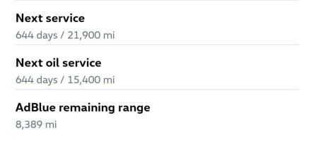

Haven't seen it in the infotainment system as I usually have Android Auto connected, but have now downloaded and set up the VW app (what a faff that was!). Anyway, under Health Check the app says:
Next service: 310 days / 14,700 mi​
Next oil service: 310 days / 16,000 mi​
So I guess that means it's set up for long interval servicing.

Yep, mine currently says this even though I did an "annual" oil service from the service plan:
