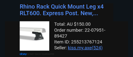

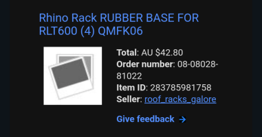

Hey mate, I used the RLT600 and will need the rubber feet and there is a spacer kit that goes on the front and rear feet to keep it level (I didn't order these and used general packers as I didn't want to wait)
Seemed the cheaper and easiest method found some in ebay at a good price. Finished up close enough to the roof for me.

Hey mate, sorry for the very late response completely forgot. I'm about 2180 including awning so you should be fine. It's quite low to the roof.
These are the details/part numbers of the bits I used, will also needed spacers for the front and rear mounts but I put one of the builders packers in between the leg and rack to get it level where needed because I got the feet then realised I needed the rubbers, I wasn't waiting again for some packers!
