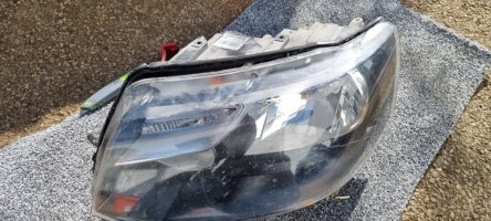

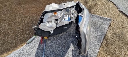

Removal of the headlamps, splitting them in half, putting projectors in place of H4 bulb and the whole reassembly took me a total of 4 hours.
I was so surprised how easy it is to separate the front lens from the rest of the headlamp. No heat gun was required, just one pretty big flat screwdriver, one prying tool and sharp blade. Just started in the top inner corner of each lamp and it went extremely easy.

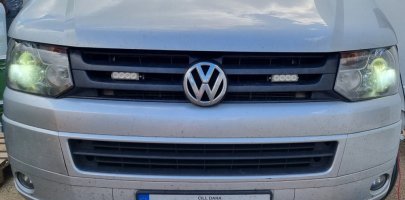

Projectors were also equipped with quite cool DRL rings. It is hard to judge the effect from photos taken in full daylight, but have a look below.
The projector kit includes few adapters/washers and the actual projector fits in the place of the H4 bulb literally like Plug & Play.
My friend didn't want to upgrade his BCM and unfortunately there was no way to adjust coding (on his BCM) to allow low beam to stay ON when high beam was ON.
As a solution, I have used one relay per headlamp to feed low beam while high was ON and simultaneously isolate the original low beam supply.
Basically, I didn't want to cut the wiring outside the headlamps and run any extra wires in between the headlamps.
Final result looks like OEM, externally there is not a single indication of anyone tampering with the headlamps.
Some final results at night.
Plus the night test drive.
