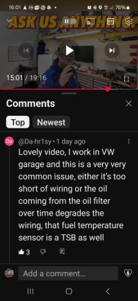

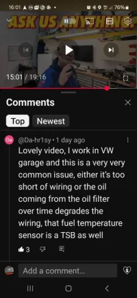

Another LIN bus cable fault, looks like a T 6.1 this time.
Note the comment as well.
