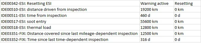

Or possibly a full fresh start as below - values before and after my van was serviced.

Thanks for your advice, I have eventually got around to sorting this problem. As advised I adapted all channels as quoted by MMI and the dash warning was extinguished. I have now readapted IDE03351-FIX and IDE03352-FIX to the figures that existed before zeroing them all in an attempt to bring the Inspection warning back up at the appropriate time / distance. Warning still extinguished, time will tell how this proceeds.
Maybe I should have reverted IDE00510-SEI and IDE00511-ESI to the previous values? I do have a note of what they were.
Soot & Thermal load were already zero but I am driving a pre DPF vehicle so I suspect that was what would be expected.
Thanks again both.
