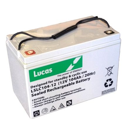

This is my spare one I was given.
After all that it seems like its leisure battery. It looks like when they test a battery they arectestibg the internals for a short and cranking capability and not if the leisure battery it still ok. I still have mine on charge and will swap it over tonight to prove it once and for all but it's been running for 2 days on my spare one absolutely fine.
