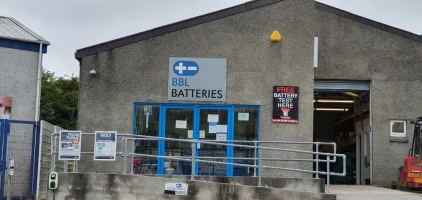

We're back in business, big thanks to @DXX for the suggestion of BBL Batteries. We headed there first thing this morning, Mark there was fantastic, can't recommend them enough. We dropped the battery in, he put it on charge for me for a couple of hours, had lunch and watched a film in the van. 2hrs later, battery back in, connected up and it's charging from the alternator again.
He even loaned me a spanner to get the drivers seat out, all he wanted was a fiver but was sure to tip him more.
Battery was down to 10.8v and now up to 12.3v. Will Keep the loads disconnected until it's fully charged and even then only run the lights...the coolbox is staying on the sidelines!
Huge thanks guys, you got me out of a right pickle and we can crack on with the rest of the week without the worry of a bricked £700 battery.
