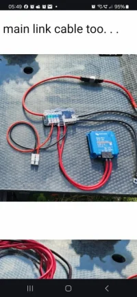

I've just been doing a similar 50A charger install.
