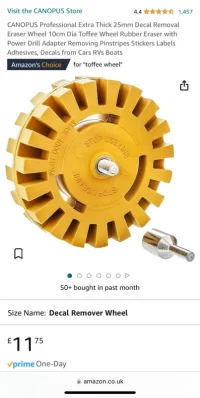

If that came off then I’m hopeful either using the wife’s hairdryer or a careful heating with the heat gun and plastic scraper will get the big bits off then either use the toffee wheel which is actually the same as the one in the link and then try and clean it down with some cleaning fluid
The toffee wheel works really well on painted metal parts not so well on painted plastic parts like say the front number plate mounting. Doh ! fortunately covered by the new number plate .
You have to use a toffee wheel extremely slowly & keep stopping on painted plastic parts like I did on the front bumper, to stop the wheel getting warm/hot & digging the paint off!!
It can be done. My bumper was going for repaint anyway so not an issue.
As stated they are easier to use on painted metal, again with care! Take it slowly & spinning slowly with minimal pressure ;)
