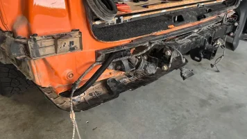

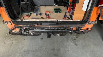

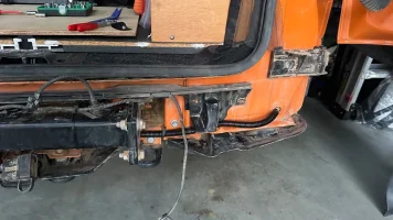

Some tow bar kits include a spacer as standard and some don't (westfalia). There is a VW part used for this purpose which some people have had to buy. Others, myself included, managed to cut the old crash structure to fit around the tow bar frame. The installer should have mentioned this really, even if it wasn't included as it is a known consequence.

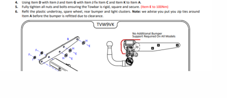

our TOW TRUST tow bar kit doesn't require the spacer . . .
the bumper skin sits on top of the bar its self. . .
so what tow bar have you got exactly?
@Dellmassive
That's interesting - thanks for the insight. Maybe it's just a normal amount of flex and nothing to worry about. It's a towtrust TVW9SN if that sheds any light.
