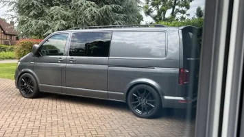

I’d just like my van lower, my last Transporter had the Bilsteins fully down with 19’s and I was happy with the stance and ride. Had a Vito before the BE on bilsteins and 19’s again was happy with that. The eibachs fully down and 20’s isn’t doing it for me, would just like it another 20mm or so lower.

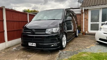

My van has STX and the front is wound right down. On the rear I fitted adjuster deletes.
You can squeeze another 10-15mm out of the rear with the deletes, but having the front wound right down means the front damping is right on the limit of the working range so it can feel a little harsh.
If I was doing this again I would fit Solow NSL which gives a wider range of drop and at the current height would be in the middle of the working range so I’d expect a smoother ride up front.

Yours looks quite a bit lower than mine on the front though, more than the 10mm I thought I had left on the threads. T32s STX might sit a bit higher than T30 maybe?
