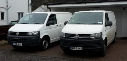

IMG_6844.JPG Hi all. This is my first post since joining today.
I must have one of the first T6 models (thought I was getting another T5!), it arrived Oct 2015 ish, and previously was waiting for me at my work place.
Since new it has had an annoying rattle. It is always there at >50mph, and intermittently there at lower speeds, I'm on >30k miles now and it is still rattling.
It sounds like it's coming from 1 of 2 places; either the very front of the dash, where it meets the windscreen. Or, the roof lining where it meets the windscreen. I'm having difficulty audiably triangulating the area, but think it is slightly left of centre.
I have read about others having issues in the roof lining area, but not the same. If I push on all the different areas - no change.
Any ideas? Doubt warranty will cover it as I've left it too long.
