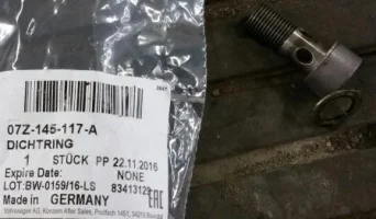

But I did manage to find out why it's been recalled...'a seal on the oil return/feed pipe'
So I hope it stays sealed until the replacements sorted!

I think so. In July. Got impression the seal is nothing urgent but just a thing to do when van is at regular service next time. I was at the dealer for other reasons so this came up when checking factory notes trying to sort the other issues.
It is just a metallic seal ring (see pic, consisting of two seals, one next to the oil plug and the other still at the head of plug). Actually the changed part is a complex of oil plug and seals (as in the pic) - oil return/feed pipe to turbo. Engine 150ps, build date Nov-2015.
