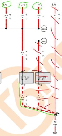

Electric sliding door with power latching system one off this site, I know its dated 2015 but its the same as others I've seen. I don't think the wiring has changed much on that side of things.
As you can see here I've crossed out the ones that don't relate. Green from the fuse down to '99 (door control unit) is known to be good after I tested with battery voltage and the door worked. Likewise I know SA3 is good as this is the 100amp feed under the bonnet, I'm also getting battery voltage at J713 and J7 so its just a case of tracing that wire back and seeing where this B311 link is (note it also drops wire gauge size here) and find out what's going on with it.

Everything i put in the downloads is for T6, is your 2011 T5 or 5.1 as thats quite close to change over ?
I have all wiring diagrams for all years/models so happy to dig through and find the ones for your model if it may help
Just had a check of the 5.1 wiring diagrams and its identical to the one above
Im pretty sure that J7 is under the passenger seat and the main join B311 is right next to it, all vans have a join under there where the main feed from the ebox splits off to other kit (or is just blanked if not in use)
just to note you wont have B310 as you have a second battery, its one or the other not both
